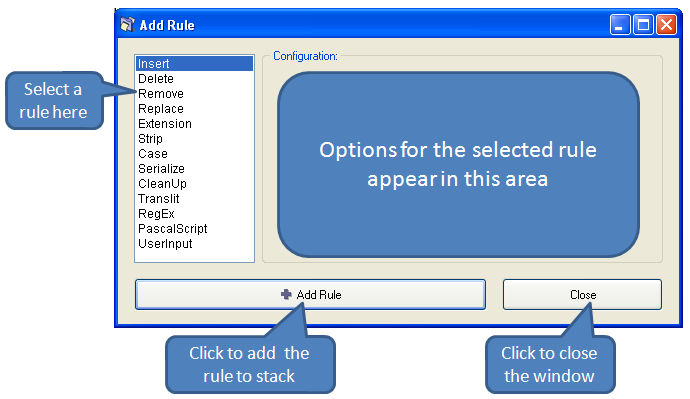

  2. The Add Rule window pops up:
    Select the desired rule.
  3. The options for the selected rule appear immediately in the Configuration area (at right).
    Set the desired parameters, as explained in each rule.
  4. Press the AddRuleButton.png button at the bottom of the window. The rule is added to the stack and the window is closed.
  5. Repeat steps 1-5 to add more rules. Each new rule is added at the end of the stack.
  6. To close the window without adding a rule press the "Close" button (or the window close icon at the top right corner).
