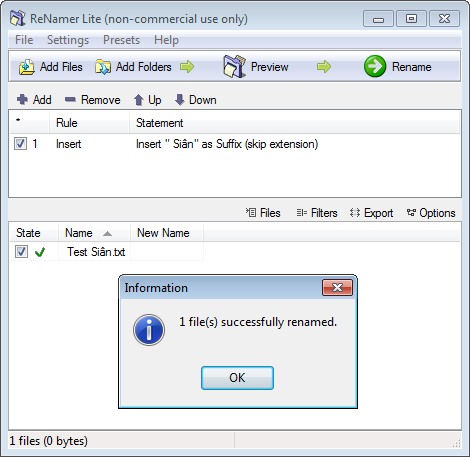

#2 2014-01-13 00:00
Re: Rename fails if "â" character in rule
I have just tried doing the same and it worked (as I would have expected).
Currently there is no detailed log with errors available, but it is a planned feature.
