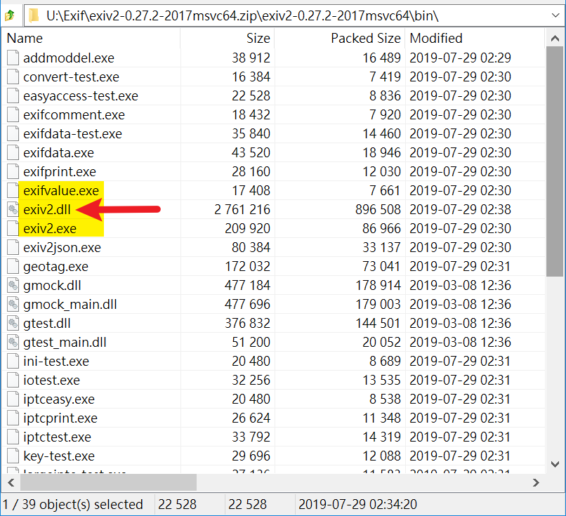

I am using ReNamer to rename the photo file, and I need to use the information of the Software tag in Exif, but ReNamer does not have this Meta Tag built in, so I use Pascal Script and use exiv2.exe and exifvalue.exe cooperates with ExecConsoleApp() to obtain this information, but this processing speed is slow, I often need to process dozens to hundreds of files at the same time.
Therefore, I want to try to use exiv2.dll with external commands, but I am not familiar with the Pascal language. The examples found on the Internet are also written in C++ language. I don’t have enough relevant experience to convert it to Pascal Script.
Is there anyone with relevant experience, please generously provide examples of using exiv2.dll for my reference, such as how to declare ExifData structure variables, how to refer to functions that read Exif tags, and how to read Software tag's content ... etc., thanks.

Hi Stefan,
Thank you for your reply, I am sorry that I did not express my needs very clearly.
I have tried to use command line commands from Pascal Script via ExecConsoleApp(), and I did get the Exif tag's data I need. However, when dealing with numerous files, frequent disk I/O actions also make the rename action slower.
Because I see that ReNamer provides the function of referencing external libraries, and Exiv2 also provides the DLL file, API documents and examples, so I would like to try to improve rename speed through this method for my script.
However, those files and examples are all based on C++, and I don't know how to convert and declare data structures, variable types and functions to Pascal Script. I need a practical related example to take me into this door.

as far as I see
- The exiv2.dll contains the functions which are called by the exiv2.exe.
- There is no documentation how to call functions from the DLL without the EXE.
That means we can't call functions from the DLL directly via command line, so we can't use it here.
- The C++ code example is for to include the exiv2 source into an own application.
- If you would could call the DLL functions by an PascalScript there would still be I/O actions for each file.
So, for such many files you deal with,... why do you not utilize the exiv2.exe just directly from the command line?
Maybe you can also suppress the output text on the console to speed up the process.
In an next step load the renamed files into ReNamer to do the more detailed work if needed.
Are you able to tell us how many files you want to rename, on which device the are located, and your complete wanted renaming steps?
Just some ideas, I don't want to stop you from your experiment with the dll ;-)
