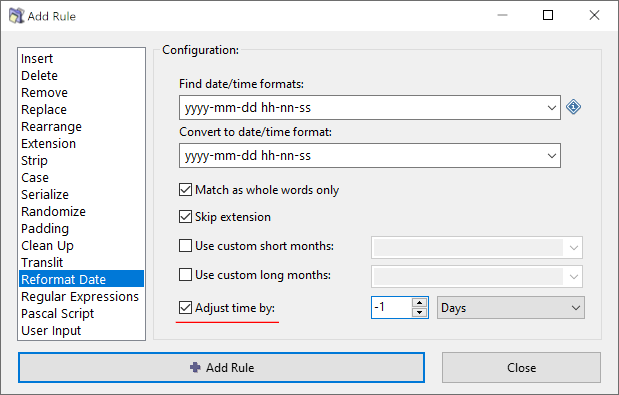

You don't necessarily need the Pascal Script rule, because you can adjust date/time in the filename using the Reformat Date rule.
So you can simply insert the current system date time using the ":Date_Now:" meta tag, and then adjust it by -24 hours or whatever you need.

For the same of completeness, here is a script for inserting yesterday's date into the filename using the Pascal Script rule:
  FileName := FormatDateTime('yyyy-mm-dd', IncDay(Now, -1)) + WideExtractFileExt(FileName);
