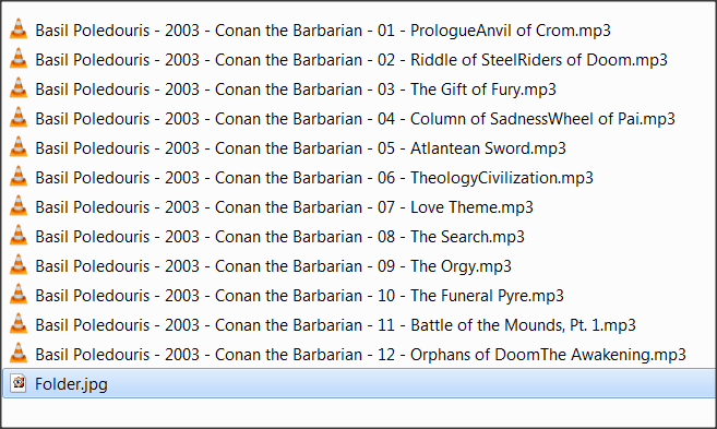

A picture is worth more than all the words, this is what I want:
very bottom of the picture you can see that the image is renamed "folder.jpg"

Ok, I think I understand...
If you want change the filename of only JPG files to "Folder.jpg", add this script as the last rule:
const
  IMAGE_EXTENSION = '.jpg';
  IMAGE_TARGET_NAME = 'Folder';
  FileExt: WideString;
  FileExt := WideExtractFileExt(FileName);
  if WideSameText(FileExt, IMAGE_EXTENSION) then
    FileName := WideExtractFilePath(FileName) +
      IMAGE_TARGET_NAME + FileExt;
You might want to learn Pascal Script as it is a very powerful tool smile
http://www.den4b.com/wiki/ReNamer:Pascal_Script
