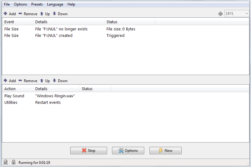

Just tried with Shutter 4.1 and same thing happens, like I said not always:
Shutter 4.1 1by1
#5 2017-12-12 11:42
Posts: 3,473
Re: Shutter 1by1 bug ??
We will check the handling of 1BY1 logic for consistency and will report back.

#7 2017-12-14 00:16
Posts: 3,473
We have identified some inconsistencies in the logic handling. Please check if your issue has been fixed in v4.1.0.1 Beta, download the latest development version.
By the way, "File Size" event can now be used to check specifically for existence of directories (or drives). Simply include a trailing directory separator to let Shutter know that it is a directory.

#8 2017-12-14 17:49
liamZ
Registered: 2017-12-11
Posts: 5
Hi, thanks a lot, now 1by1 logic works fine!!! smile
